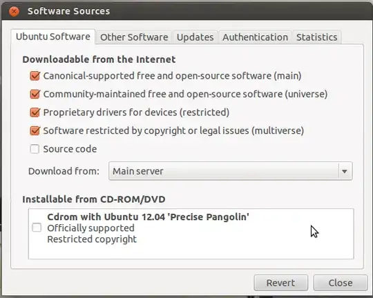

Go to Ubuntu Software Center -> edit -> software sources Check this:
  • Main
  • universe
  • restricted
  • multiverse
  • canonical partner (optional)
  • indepedent

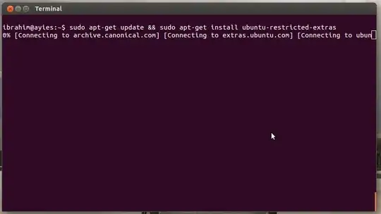

and open terminal and doing this:
sudo apt-get update && sudo apt-get install ubuntu-restricted-extras
If you install ubuntu restricted extras it will automatically install flash. I hope this help and can close your case.
