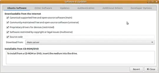

Some mirrors may be out of sync.
Try to select other mirror:
  1. open Software & Updates (software-properties-gtk)
  2. on Ubuntu Software tab select other server (for example Main Server) from Download from drop-down menu.
  3. if you planning to compile something check Source code
Software & Updates - Ubuntu Software
  1. confirm reloading lists
Then try to install you program again with:
sudo apt-get install libsqlite3-dev
