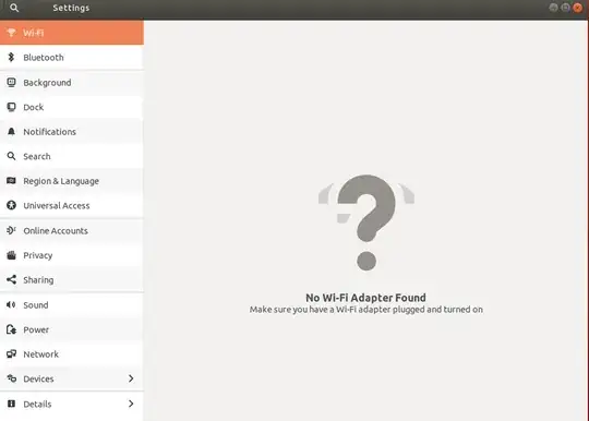

I have also just tried to connect using the mouse. This is what I see when I go to the WIFI in settings:
No_AdapterFor the no adapter issue, this Youtube video looked promising.

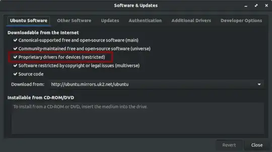

For the package bcmwl-kernel-source to be available, you need to enable the restricted repository.
You need to run software-properties-gtk and enable the restricted repository.
Software & Updates
Then you will be able to install bcmwl-kernel-source
