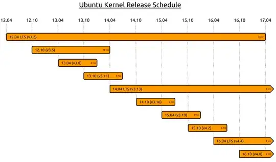

I also found ubuntu kernel release schedule
Not sure but it may point to one inconsistency in my setup. I run on kernel 3.16.0-50-generic which seems to correspond to release 14.10 and not to 14.04. Is this an upgrade path issue ? If so, how do I correct that ?
