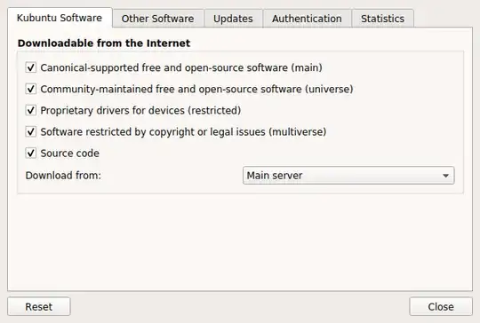

Fixed my problem Following this answer at last!
So in my Kubuntu 18.04, I must open the Software Sources:
$ sudo -H software-properties-kde[sudo]
password for lau:
QStandardPaths: XDG_RUNTIME_DIR not set, defaulting to '/tmp/runtime-root'
The problem came from all the items under this tab are unchecked for some reasons:
Ensure all of them in this tab are enabled:
Then I run the commands for installing Mariadb again. No more errors!
