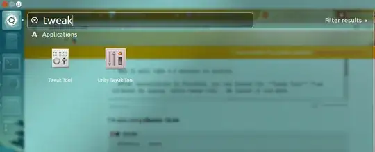

  • After installation is finished, you can launch the Tweak-Tool from terminal by typing unity-tweak-tool, OR launch it via Dash.
Tweak-Tool from dash

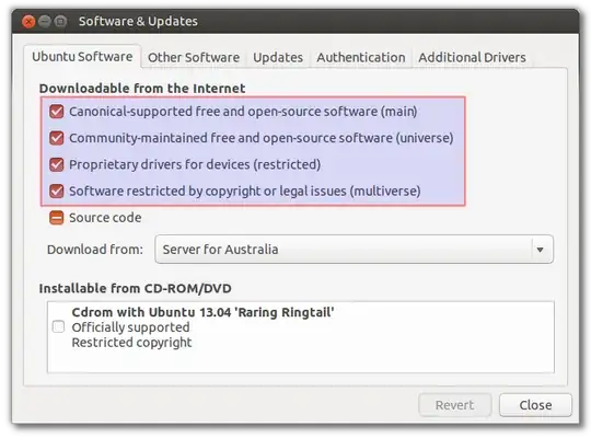

I'm using Ubuntu 18.04, it's March 2019 and I've just installed unity-tweak-tool through the terminal this way:
On Ubuntu, open "Software & Updates" screen. Search for it in your dash.
Check The first 4 options, as on the screenshot:
install unity-tweak-tool on Ubuntu 18.04
It will ask to do a update when you save. Allow it.
Open your terminal and install normally: sudo apt-get install unity-tweak-tool

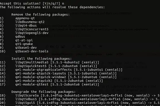

This was really problematic for me as I had many other cases in which the dependency tree was broken and it was impossible to install or reinstall some packages like unity-tweak-tool.
At the end, the solution was pretty simple. You need only to use aptitude instead of apt-get. It has a smart way to handle broken dependencies. In my case, I run:
sudo aptitude install unity-webapps-common unity-tweak-tool
From there I got to a proposed fix. The first approach proposed was not effective but if you write n instead of Y it will propose you something else (in which there is removing, installing and even downgrading many packages). You type Y and it is done. Following is part of the fix that worked for me:
