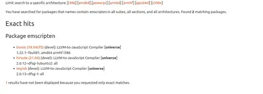

So I followed the steps and searched in packages.ubuntu.com for the emscripten package and found it in universe. enter image description here
All good, so I open Software&Updates and I find that I already have universe enabled.
Of course, I've used both sudo apt-get update and apt-cache search. The last one gives me, indeed, this result
apt-cache search emscripten
emscripten-doc - LLVM-to-JavaScript Compiler
So it sees the emscripten-doc package, but not the emscripten package.

Ubuntu 20.04 LTS misses this package in official repositories.
You can download this package from previous 18.04 LTS release and install it manually by using commands below:
cd ~/Downloads
wget -c http://archive.ubuntu.com/ubuntu/pool/universe/e/emscripten/emscripten_1.22.1-1build1_amd64.deb
sudo apt-get install ./emscripten_1.22.1-1build1_amd64.deb
