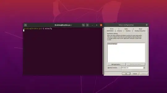

     WINEARCH=win32 winecfg
    in the terminal to make sure it configures Wine correctly (In that order). You will also need to install winetricks (Another configuration package, really helpful for installing Windows components like .NET Framework and other needed libraries). So after this, please do:

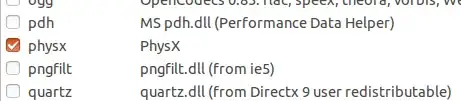

To play HL/HL2 you need the Wine PPA as mentioned above. After opening winecfg at least once on the terminal, open winetricks by running winetricks --gui then follow this steps:

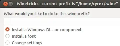

Select Select the default wineprefix
Select Install a windows DLL or component

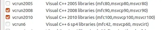

Install all that I have marked (and any additional you need). This covers many apps:
Right click the installer for HL/HL2 and select Open with Wine. Both games should work perfectly. This applies to apps in general and depending on the app you will need to install more or less components.
You can also install each component in terminal by adding the name of the component after the winetricks command:

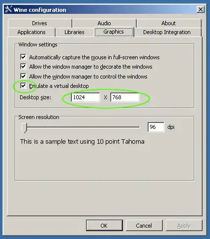

  1. When troubleshooting an App, always run the app in an emulated Desktop Window. Open winecfg go to Graphics and enable Emulate a Virtual Desktop. Then set the resolution for it. This way, if the app freezes, hijacks the keyboard and/or mouse focus, at least you have a way to eliminate the app instead of having it fullscreen where you have few choices:

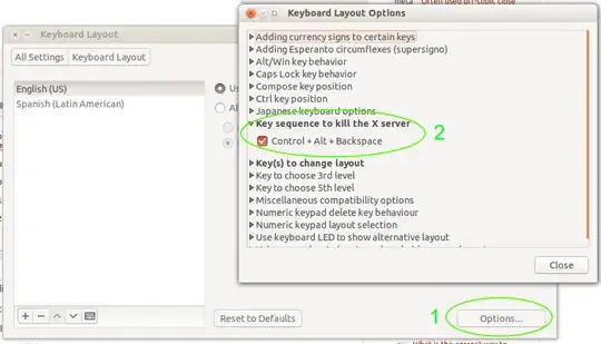

  2. For freezing scenarios of an app at fullscreen I suggest activating the "Kill X" feature that is found in the Keyboard Layout Window which can save you several seconds of time when trying to get out of a frozen Wine app:

6. How do I open multiple Wine apps without them using the same Window (Overlapping)
You can setup multiple Wine windows by adjusting some Wine parameters before starting each individual Wine program. The fastest way is to open the terminal where the executable of the app you want to run exists. Let us assume it is the Wow.exe app. Then simply type the following:
wine explorer /desktop=WOW,1024x768 "Wow.exe" -opengl -console
This would open the Wow.exe executable with a Window titled "WOW", a resolution of 1024x768 for that specific Window and it would apply the parameters -opengl and -console to the Wow executable. Now assuming you have the game installed somewhere else, you would the following change:
wine explorer /desktop=WOW,1024x768 "/media/cyrex/fun/wow/Wow.exe" -opengl -console
This executes Wow.exe assuming it resides in the folder wow inside a partition called fun in your /media/USER folder. The output should be similar to this when running for example 4 apps:

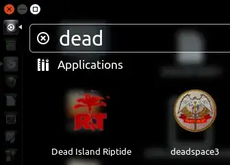

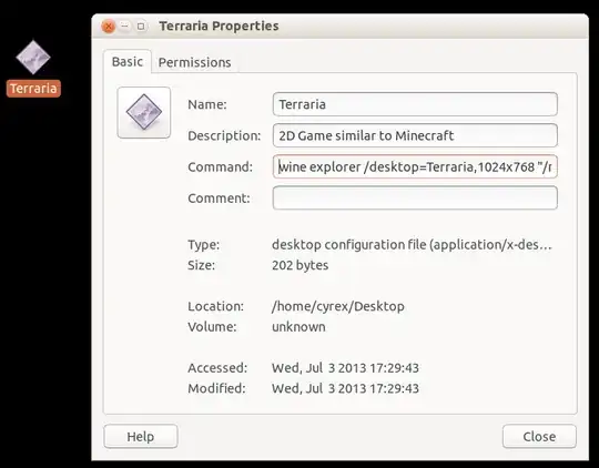

There is a more easier way to accomplish this. The idea is to create a Desktop shortcut by right clicking on the Desktop and selecting New Document --> Empty Document. This should create an "Untitled Document" file on your desktop. Now open the file and paste in it the following:
[Desktop Entry]
Type=Application
Now save it and rename the file to the application you want to open but at the end add ".desktop". It will turn into an "Executable Windows Icon". Now right click the Icon again and go to Properties --> Permissions --> Activate Allow executing file as program. Now go to the Basic Tab and insert the information you need to execute that wine app. The end result should be something like this:

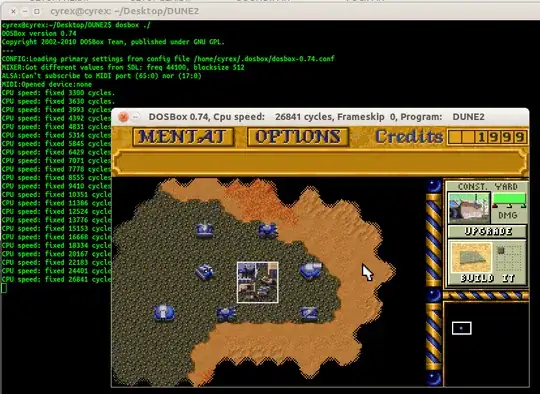

DosBox (DB)
DB from https://www.dosbox.com is to MS-DOS apps as Wine is to Windows apps. With DB you can run MS-DOS apps in your system. Simply install the dosbox package and you are done. Running an app is as simple as going to the folder where the app resides and executing the following:
  `dosbox ./`
This will open the current folder as a drive letter on the DB environment.
You can also mount a folder by doing the following after opening DB:
   `mount x: /Absolute/Path/To/Folder/Of/App`
For example
   `mount c: /home/cyrex/Desktop/Dune2`
Will create the C: Drive letter which contains the Dune2 folder. So if I simply execute dune2.exe I get the following:

  • Dealing with apps that take hold of you mouse and/or keyboard, you can use wineserver -k to kill the app, opening the App in Windows mode or setting the Windows mode with the wine explorer /desktop parameter will save you from having this mouse/keyboard problems.

(Copy and Paste)To run wine type winecfg in your terminal :
winecfg
Click Below to see results
In the terminal to make sure it configures Wine correctly (In that order). You will also need to install winetricks (Another configuration package, really helpful for installing Windows components like .NET Framework and other needed libraries). So after this, please do:
