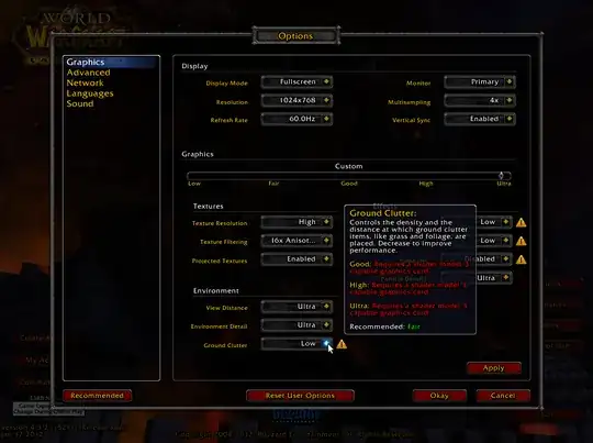

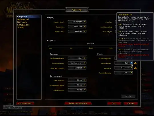

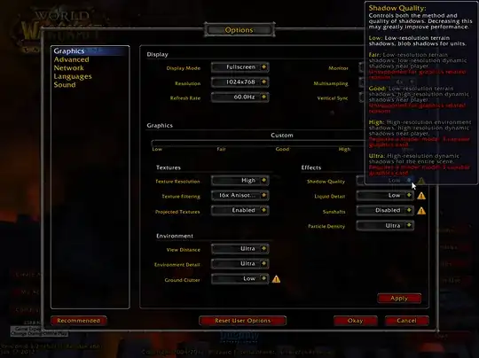

When I ad the -opengl parameter and edit the Config.wtf leaving OpenGL in the GxApi variable like I mentioned above I get this:
As you can see from the 2 pictures, Multisampling went from 16 to a maximum of 4. Shadow Quality went from Ultra to Fair with a warning saying "Unsupported for graphics related reasons". Liquid Detail went to Low as the only option and Ground Clutter went to Low as the only option.
