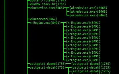

Here is an image of pstree -g when running a Wine app (In this case STALKER Call of Pripyat)
If I do a sudo kill -9 8462 it will only kill the wineserver and leave me with a GUI window stuck on zombie mode. If I however do a wineserver -k it will correctly kill all Wine related processes (8491, 8468 and 8462). For more information about other wine related commands please see How to install and configure Wine? where I took some effort in compiling almost all useful commands, wineserver being one of them.
