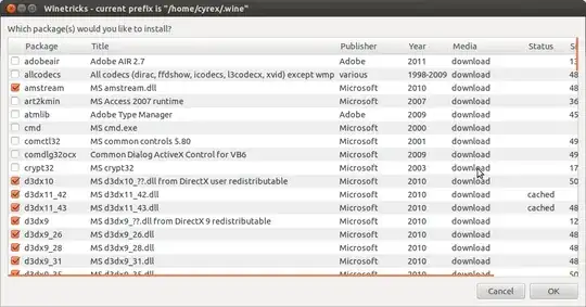

Using the PPA from Wine and at least starting with Wine 1.4 I can confirm that Winetricks now saves the state of each setting. If they are installed they will show with a marked checkbox. The image below shows for example the settings I have installed:
Thanks to Christian for pointing me out a couple of minor details:
  1. If the package installed needs a manual installation (Like ie6) in all the cases I have tried it never appears checked.
  2. If the package has multiple installs (like allcodecs which installs several apps) and one of them fails, it does not show marked because it thinks they all failed.
  3. Some packages show if you do the install using winetricks with the GUI option (winetricks --gui) and not when you do the install through the terminal.
  4. There might be a need to delete the .wine folder, purge all related packages and even delete the ones stored in cache. Basically start from scratch. This at least cleared a couple of issues I have back then.
