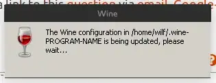

You should then get a window like this:
the wineprefix is being updated....
Then you are ready to go. Now you can install NET 4.0 using winetricks (you might want to get the latest version from here first):
