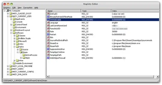

One alternative to updating your launchers to pass the -no-dwrite option is to disable DirectWrite support in Steam's preferences. While you can do this within Steam if you can navigate the menus and settings dialog box with no text, it is probably easier to change the setting outside of Steam.
With Steam closed, do the following:
  1. Run wine regedit.
  2. Navigate to HKEY_CURRENT_USER\Software\Valve\Steam in the tree on the left.
  3. Look for a DWriteEnable value in the pane on the right. If it doesn't exist, add it as a DWORD value.
  4. Set DWriteEnable to 0 and exit out of the registry editor.
Your existing launchers should now start Steam with visible text.

The no-dwrite registry modification should also be possible with this command:
wine reg add 'HKCU\Software\Valve\Steam' /v DWriteEnable /t REG_DWORD /d 00000000
Note if steam is installed under a specific prefix (e.g. ~/.wine-steam) you may need to prefix the command with the appropriate environment variable - so for instance :
env WINEPREFIX="$HOME/.wine-steam" wine reg add 'HKCU\Software\Valve\Steam' /v DWriteEnable /t REG_DWORD /d 00000000
Source: Wine AppDB entry
