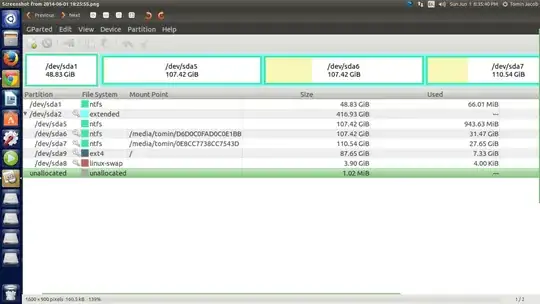

Before that, I installed Wine on my Ubuntu. I used it to install some software like Picasa. When I tried to open some images on a NTFS partition using Picasa, I was unable to view or access these partitions. I will show my partition details -
Screenshot of GParted
As you see, I have 4 NTFS partitions in total. When I opened Picasa and searched for the partitions in which the images are saved, I was unable to find some partitions (sda5, sda6 and sda7).

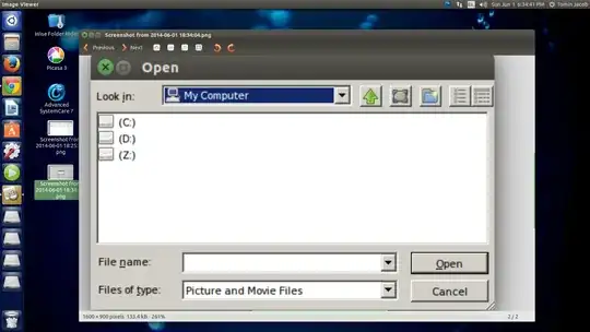

Picasa open image dialog
This is the window that was opened by Picasa when I tried to search image files. How can I access the partitions in which the images are stored from Picasa?

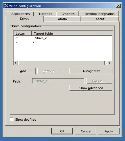

Wine, trying to mimic how the drive letter works in Windows, also includes the Z: letter for the root file system on Ubuntu as shown in the Drives option in the winecfg:
Just open winecfg and go to the Drives tab to see which letters are assigned to which folders.
A quick example of how Z: looks if I try to search on it:
As you can see, from here I can navigate to media and find the NTFS partition from there. In your case it would be in /media/tomin/.... You can also add new letters that point to a specific folder, like letter D: if you wanted to point directly to the NTFS partition.
As Takkat mentioned something VERY important in the comments, Wine can not mount a file system (Mounting is a Ubuntu system action, not so much a Wine option). So you need to first mount the file system, via File/Nautilus for example, and then proceed to use the Wine app you need.

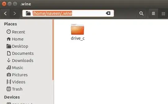

C: drive shown to you in Wine, is not a real partition but actually a regular folder exists in your Linux home directory.
If you execute the command below in Terminal, you will see the corresponding folder for Wine's C:
nautilus $HOME/.wine/

These are good answers. Also note in Gparted /dev/sda1 and /dev/sda5 are not mounted. There is about 1 GB of data between them, and maybe those are the files you are looking for?
You can edit those paritions inside Gparted and set a mount point so that they will always be available. Right click the partition in the text list and select properties (I think that's the menu entry). You specify the mount point. But the change will not apply until you hit the green check mark at the top of Gparted.
