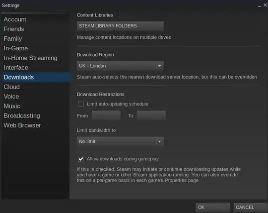

Now just open steam and then, from the drop down menus, go to >> Steam >> Settings, choose downloads on the left then click STEAM LIBRARY FOLDERS button.

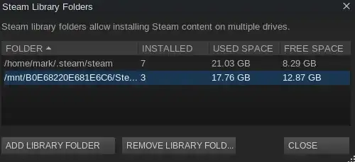

You should see a box listing only your steam install directory, click ADD NEW LIBRARY FOLDER and point it to the location of your folder.
Now your new drive is added and it will look, something like, this
