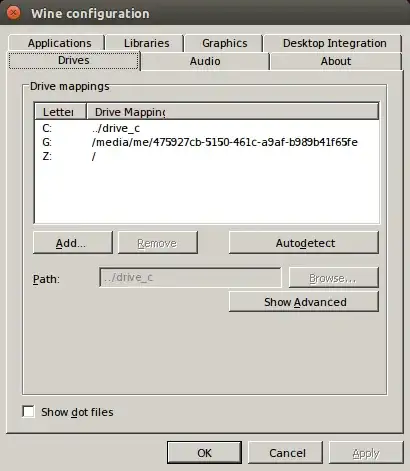

Run the Configure Wine application from the launcher or open a terminal with CtrlAltT and issue the command winecfg Either way you will get a Configuration Window for Wine. Insure that you are emulating the right version of Windows for your application and that the settings on all the tabs are sane. Drive Mapping Example Below:
Note: In a typical installation of Wine The directory noted in your question can be found at ~/.wine/drive_c/windows/system32 and you can examine the content with the command.
