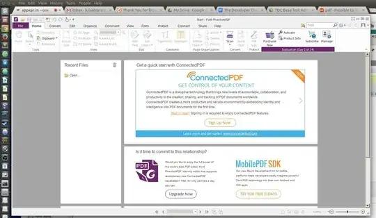

So I followed the links provided by nutty about natty and tested the app using a fresh install using Wine 2.15 (August 20, 2017) with 32 bit (Like the guide I created. Just followed the steps up to the point after running winecfg).
At that point I tried installing the MSI package and the installation went well until at the last window of the installation it told me it failed prematurely and it basically deleted everything that was installed when I clicked on the OK button to finalize the installation.
So what I did was install it again, but instead of clicking on the OK button at the end after the getting the error, I went to the Fox It folder, copied all the content, put it somewhere else and then click on the OK button. After the installer deleted everything again, I overwrote the destination folder with the backup I had created. Then I simply ran the executable and:

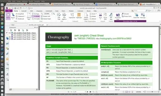

Here is me studying AWK again (I suffer from really bad memory so I need to study and repeat things multiple times for them to stick):
Note that this was done without any winetrick apps. Just installing wine, doing the backup once the installer fails and that was basically it. If there is any issues then is probably something additional that was installed. This was tested using Windows 7, but it also worked on Windows 8 and 10.
