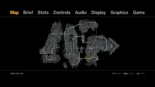

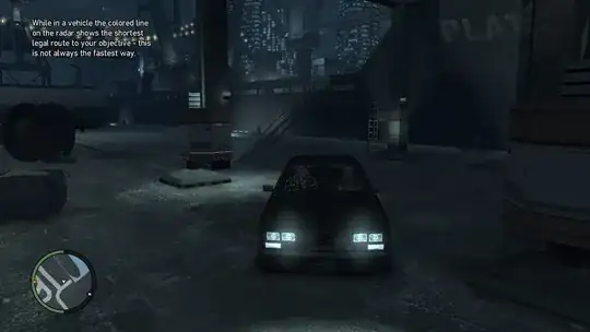

Here are some screenshots of the game in action:
