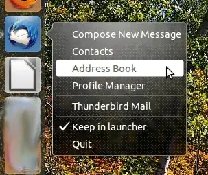

Here are some of my earlier efforts.
Files
Mozilla Thunderbird

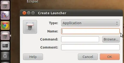

103
For 11.10 and newer:
You can still create the Launcher on the Desktop by using the old GUI dialog.
Using ALT+F2 type:
gnome-desktop-item-edit --create-new ~/Desktop (Capital D)
This will start the dialog( Create launcher):
You can put this .desktop file in any folder, and then drag and drop to the launcher.
Note: The package gnome-desktop-item-edit must be installed first, so if you have gnome-panel installed, then it is installed automatically.

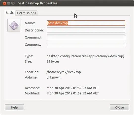

22
For me in 12.04 I do the following:
  1. in the Desktop create an "Untitled Document". Just right click in the Desktop and select Create New Document.
  2. Edit the file with Gedit and add the following lines:
[Desktop Entry]
Type=Application
Save the file and THEN rename it to whatever you want but at the end of the name add .desktop. For example if I wanted to make a shortcut for a wine program like photoshop I would put as a name photoshop.desktop
Now you should be able to right click the file and the Launcher Properties should appear like this example:
As you can see in the image now you can put whatever you want in the command line, another name, an icon for it, etc..
Don't forget to set Permissions as executable! Otherwise it will not work.

  2. Open the app you want to add.
  3. An icon will appear in the launcher, right click the icon, and click Pin to launcher.
  4. To remove an app from the launcher right click the launcher icon and Quit

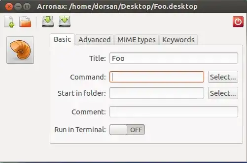

For those who like having a GUI: In 12.04 you also have the option of using Arronax which is a Nautilus plugin to create your launcher (.desktop files to be more accurate), heres an explanation of how it works.
If you already have the application launcher you can simply right click and click on the "Create starter for this file" option as shown below.
If you have desktop icons enabled you can create your own launcher with specific commands by simply right clicking on your desktop, this will give you the following option to create a blank starter:
Once you have clicked on "Create Starter" you will have the following dialogue box open where you can easily customize your starter with whatever command you'd like:
Once you've saved your launcher to your desktop you will see a file as shown here:
You then simply pick it up and drag it onto your dock in whatever place you like: enter image description here
A couple of nice features:
  • Being able to assign Keywords to the command so it becomes searchable through the unity dash.
  • Relatively quick to create launchers for Windows programs in Wine as explained by this youtube video (haven't tested this out myself though)
Installation
Disclaimer prior to installing: Arronax is still in an Alpha stage of development due to there not being that many programmers working on it, I haven't had a single issue with it but I prefer giving you a heads up in case this affects your choice on installing another PPA you don't know.
To install using the terminal window (Ctrl+Alt+T to open it) type in the following commands:
sudo add-apt-repository ppa:diesch/testing
sudo apt-get update
sudo apt-get install arronax
After doing this you will have to restart Nautilus either by logging in and out, or by typing the following in the terminal window:
nautilus -q

First create the Launcher on the Desktop (only temporary)
  • right click your desktop
  • select Create Launcher...
  • create the custom Launcher as you want to.
Now you got the launcher on the Desktop. If you are satisfied with it, get it in the Launcher Panel:

Easy solution:
  1. right click on your Desktop and choose "Create launcher..."
  2. save the launcher
  3. move it to some folder where it won't bother you. (if you delete this file your launcher will be deleted from the dock as well)
  4. drag the launcher to the dock.
