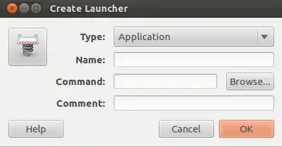

If the file does not exist create a .desktop file for Eclipse in your ~/.local/share/applications/ folder using gnome-desktop-item-edit, ie:
gnome-desktop-item-edit --create-new ~/.local/share/applications/
On the name set it to Eclipse, on the command enter the path to the binary file of Eclipse, insert a comment if you want and click the icon to select the icon that you desire for Eclipse.
Press ok when you are finished.

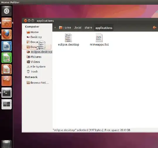

After copying the file or creating your own open that folder location
nautilus ~/.local/share/applications/
Locate the file you just created and drag it to the launcher

Run the Gnome "Create Launcher" from the terminal like so:
A dialog box will appear.
  • For Name: you'll probably want to name it "Eclipse".
  • For Command: browse to where the Eclipse executable is located.
  • For Comment: something like "Eclipse IDE" should do.
  • For the icon, click the springboard icon, then navigate to the folder where the executable is located and select icon.xpm.
  • Click Okay. You've now made the launcher icon. All that's left is to put it in the launcher bar.
