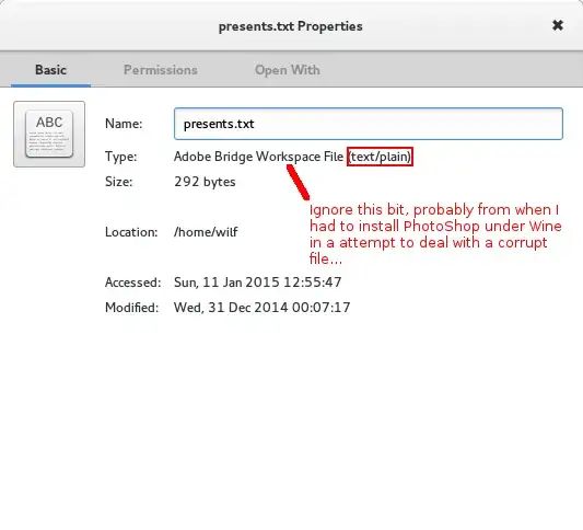

It is possible to set a portable application as default, but if you have a special filetype (e.g. .skp for SketchUp under Wine), you need to create a mimetype, and then add the 'MimeType' to the launcher file (I found this out by looking at wine deals with stuff by placing launchers in ~/.local/share/applications and stuff in ~/.local/share/mime). You can check if it has a mimetype by looking at the File's properties in Nautilus (may work with other file managers):
screenshot of file properties window

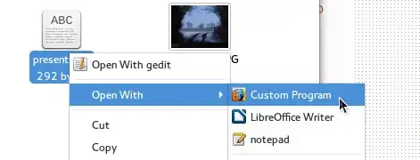

save it to ~/.local/share/applications/Custom Program.desktop, and you should get (perhaps after logout/login, restarting the file manager, running update-desktop-database ~/.local/share/applications/ or something):
Which should be able to open txt files in nano in gnome terminal. You should also be able to make this program default in the File manager;s properties.
