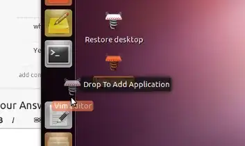

Create Launcher for Terminal Application
Right click on the desktop and select Create Launcher from the menu:
Choose Application in Terminal and give the desired name and command to run (in this case vim).
Then simply drag and drop this icon on the Unity Launcher:
