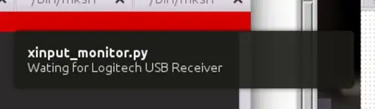

The script will issue a notification that monitoring has started:

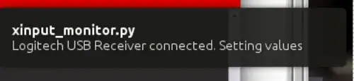

Once the device is connected, it will issue notification that device has been detected:

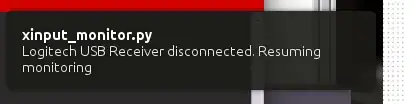

If everything is OK , the script proceeds silently and waits till device is disconnected:
