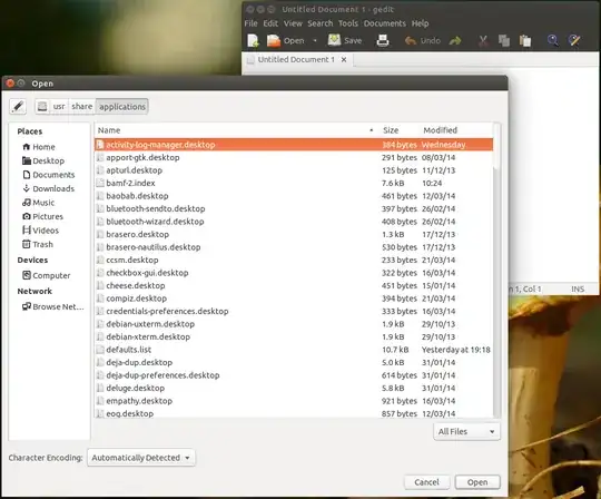

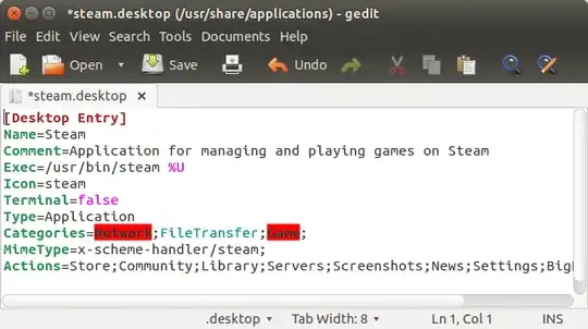

Here is an image
To create this file globally you can run your favorite text editor as root using sudo, using the terminal application. If it's a graphical editor, keep your environment clean by adding the -H flag:
sudo -H gedit
Browse to the /usr/share/applications/ directory. It should look something like this:
Select any .desktop file, it should look something like the steam.desktop example above. After you have edited it it should be close to this:
[Desktop Entry]
Name=Fritzing
Comment=
Exec=sh [link to file]
Icon=[link to icon(not required)]
Terminal=false
Type=Application
Categories=[choose what categories you want this file to fit into such as Game,Browser ext.]
