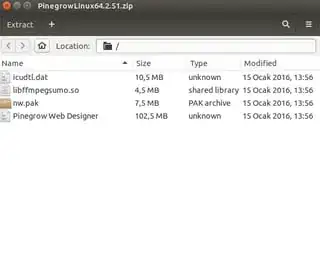

I have downloaded the PinegrowLinux64.2.51.zip file. Here is the content. What do I do from this point on?

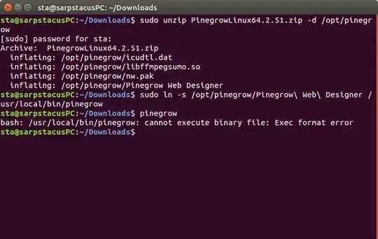

I have tried the following and the outcome is seen as:
Extract the contents of the archive (preferably to /opt):
sudo unzip PinegrowLinux64.2.51.zip -d /opt/pinegrow
Now create a symbolic link for easier running:
sudo ln -s /opt/pinegrow/Pinegrow\ Web\ Designer /usr/local/bin/pinegrow
You can now run the program with:
pinegrow
