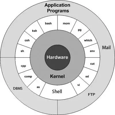

Have a good read here: http://www.tutorialspoint.com/unix/unix-getting-started.htm --- the diagram below is a graphic example of a Unix system architecture from that site (it's a link, not a copy...)
You can run bash in a terminal, in a virtual console, in a background program. Your system is probably running several instance of bash right now.
As far as any Unix system is designed, the graphical interface and the graphical applications are just another kind of application programs --- this is one of the reason that Ubuntu (and all other Unixes) can use several different graphic interfaces.
