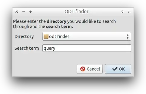

First time launching the script you will be greeted with an entry dialog for the folder you want to search through and the search term:

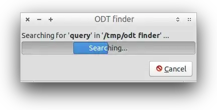

Click on 'OK' to start the query. This might take a while:

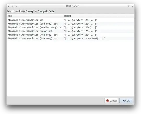

When the result window pops up you can double-click on any of the entries to open it in your default viewer (LibreOffice, generally). You can do this for more than one file:

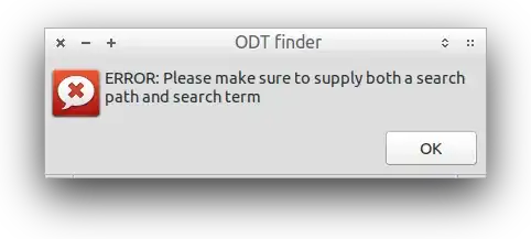

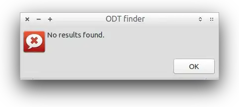

There are some basic checks to guide the user and warn them if something went wrong:
