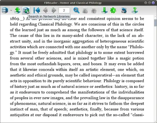

Use FBReader, which is available as 'Ebook Reader' in the Software Center (fbreader in Synaptic Manager). Less bulky than calibre.
It can open a variety of ebook types, including 'azw'.
To open ebook on single/double click, the executable file to be added is usr/bin/fbreader.
