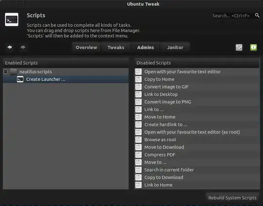

You can use Ubuntu Tweak for this . Then launch it , Under Admins menu , in Personal , Scripts , here
Drag the Create Launcher option from Disabled scripts to Enabled scripts column, then go to the folder where you have the file to be added to the launcher and right click anywhere on the folder and select Scripts -> Create Launcher from the context menu.
Create Launcher dialog box will pop up. Enter the desired name, browse for the file, Add an icon and comment if you need.
The launcher is created in the current folder so drag the launcher to the Unity Launcher panel and you are done.
