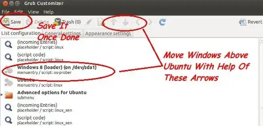

Try using grub-customiser it is available in software center.
Under List configuration tab > Move windows to the top as shown in below image and save it
Under General settings tab > default entry > predefined- entry 1 by position enter image description here
