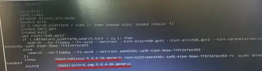

As you can see in Ubuntu parameters is the 5.8 version. I need somehow to change it to a 5.4 version that I can find in Advanced options for Ubuntu.
Ubuntu parameters from Grub2:
Edit_2
How can I change the code from 2 picture to use the "Ubuntu, with Linux 5.4.0-59-generic", instead of "Ubuntu, with Linux 5.8.0-36-generic"?
A potentialy bad solution:
Created a new menuentry "Ubuntu_2" using the script of the menuentry "Ubuntu", and replaced the "linux" and "initrd" lines with the code from "Ubuntu, with Linux 5.4.0-59-generic". It worked.
