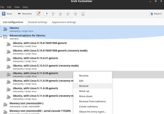

You can do that using the grub-customizer Package. You can install it using:
sudo apt install grub-customizer
After installing the package you can launch the application using:
grub-customizer
You'll get an interface like:
Right-click on the kernel causing errors( 5.4.0-92-generic), and select remove:

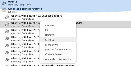

Now, right-click on the working kernel ( 5.4.0-91-generic) and select move up:

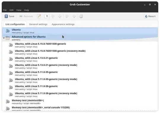

Click on the save button to save the changes:
After doing the above run this in a terminal:
sudo update-grub
sudo apt autoremove
That's it!
