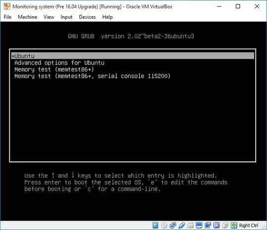

When I boot, I press shift so as to see this:

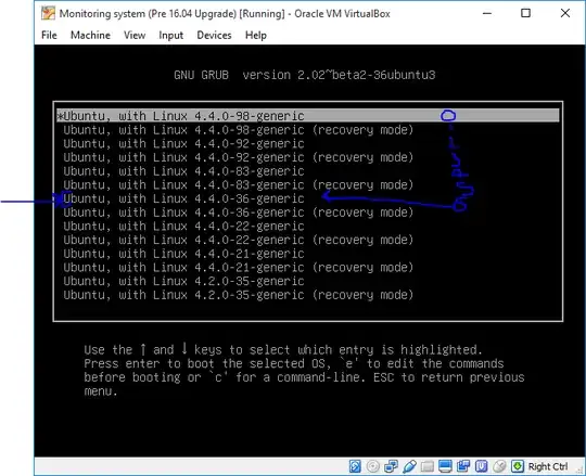

I go to Advanced options for Ubuntu, to see:
and I wrote which one I want to boot.
It is the 6th, counting the first at 0.
On Kubuntu, I go to /etc/default, open grub, change GRUB_DEFAULT from 0 to 6, then run update-grub.
But it still does not work when I reboot the virtual machine.
