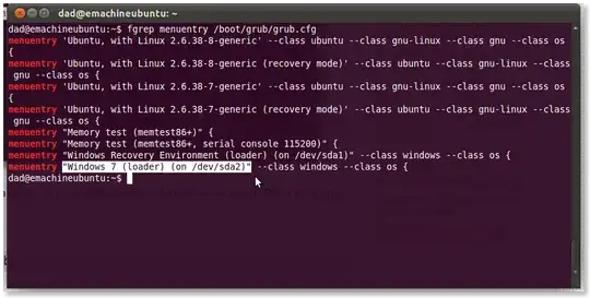

With a bit of command line trickery, you can get the default of grub to always be a particular grub entry - for example Windows - no matter when a new kernel is installed.
In a terminal type:
fgrep menuentry /boot/grub/grub.cfg
This will display all your grub entries - for example
Highlight the entry you want to default to - for example Windows 7 in the screen-shot. Right click and choose copy
Type
gksu gedit /etc/default/grub
Change the entry
GRUB_DEFAULT=0
to
GRUB_DEFAULT="Windows 7 (loader) (on /dev/sda2)"
i.e. paste the entry you want (including the quotes)
Save, then type
sudo update-grub
source

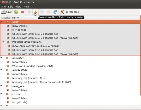

You can follow this nitstorm answer here ,
You will have to add Grub-customizer through
sudo add-apt-repository ppa:danielrichter2007/grub-customizer
sudo apt-get update
sudo apt-get install grub-customizer
Then launch it from dash , application lens.
the above menu will be different to yours, so choose wisely and select the Windows 7 entry and from the top Menu bar , select the ^ arrow to move it upward to have the top position , while booting.
For booting into Windows directly select the preference and reduce the boot-time to load windows.

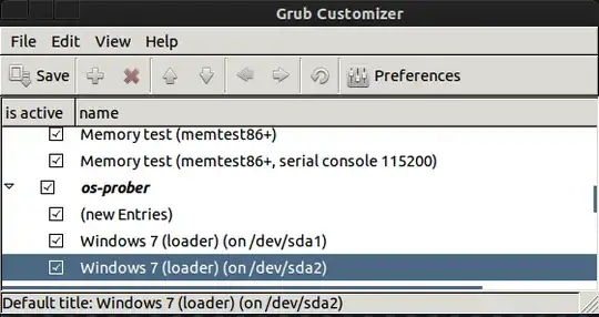

It can be done easily with a GUI tool called "Grub Customizer".
What is Grub Customizer?
Grub Customizer is a graphical interface to configure the grub2. The application allows the user to add, remove, freeze, rename and reorder boot menu items
How to install?
Hit Alt+Ctrl+T to open terminal and run following commands one by one:
sudo apt-get update
How to use?
  • Once installed, Hit Super key (Windows key) to open Unity dash and search for "" and open it.
  • Select the Linux group by clicking on Linux and move it down by clicking on down arrow in toolbar. Once done, Click on save. That's it!
Remember that you can't move single entries out of their respective group like Ubuntu can't be moved out of Linux group.

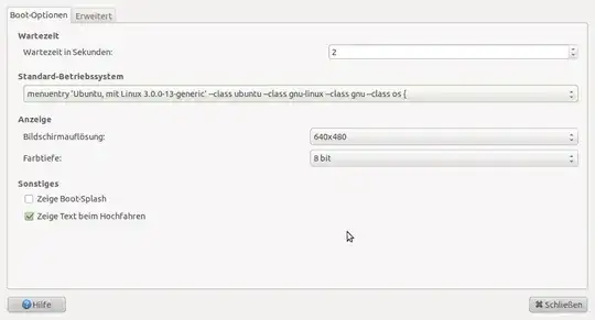

11
Use startup manager, which you can start from the dash. There you can use the OS to start with in the dropdown menu.
startup manager

This is actually quite easy to do. First, you need to find out what Grub names your Windows entry. You can do that by looking in /boot/grub/grub.cfg or by running this command:
sudo cat /boot/grub/grub.cfg | grep -i Windows | sed -e 's/^.* "//g' -e 's/".*$//g'
What that command does is search for Windows in /boot/grub/grub.cfg and remove the text outside of the " characters.
The command will output something like Microsoft Windows XP Professional (on /dev/sdb2).

I use grub customizer to do that. You can have it automatically boot into a certain OS every time or just boot into whichever OS was booted last. It is easy to install and use.
In ubuntu, open your package manager; under settings you should find "Configure Software Sources." Click on that and enter your password. Now click on the second tab entitled "Other Software" and press the add button toward the bottom. Enter in the PPA for grub customizer :
Click OK and a couple of new lines will show up; close the Software Sources dialog now and push the check for updates button on your package manager if it didn't already start to update the available packages. Type into the search function : "grub-cus" and you will see the grub customizer at the top of the list. Mark it for installation then click apply to start the process. Agree to install any dependencies so they get installed automatically as well.
After installation, you can find grub-customizer by typing "grub" into the search dialog or you can also find it in the menu under Applications>Settings>Grub-Customizer.
Alternately you could just open a terminal and run the following commands:
sudo apt-get update
You may want to pick out a pretty picture to use as background to your grub boot menu.

Normally when I have to "mess up" the Grub I use "Grub Customizer", it has a GUI so you can see easily what you are changing. Just type this into the terminal:
sudo apt-get update
Then search in the Dash for grub customizer and change the predefined entry to Windows.
