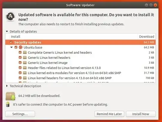

To prevent any further updates in the meantime:
You would, just NOT install the updates... simply uncheck the boxes with anything related to those updates.."5.4.0-1XX" ... linux image and header files... (unrelated system pictured here) enter image description here
On my system, I ran sudo apt update and then sudo apt list --upgradable.
Then I searched through the "upgradable list" for anything that resembled the next kernel upgrade... 4.15.0.175 in my case... I found linux-generic, linux-headers-generic, and linux-image-generic.
I could simply uncheck those in the GUI, but I know I don't pay attention to what's going on there. So instead I'll permanently set those packages to "hold".
sudo apt-mark hold linux-generic linux-headers-generic linux-image-generic
apt-mark showhold verifies...
Don't screw this up at this point... DO NOT go up to that box and hit "Install Now" without unchecking those boxes. The hold stops the install of those packages on the command line if you use apt upgrade (and to be honest I rebooted before I attempted the upgrade, so I'm not even 100% confident in that assessment), but I don't know if there is something in the background that is going to prevent from that box, that was already open, from doing what it knows to do, which is install all the "checked" packages. So CLOSE THE Software Updater and reopen it if you want to see your changes work. The apt-mark hold basically unchecks those boxes for you(and doesn't let you check them anymore) until you unhold them. [I had failed results the first time i tried this, but that could have been because I tried to hold a SPECIFIC kernel... don't do that, just hold the package without version]
When I upgraded with either method, the next kernel did not get installed.
Now if those are the only packages that need upgrading, Software Updater says my system is current. If I do sudo apt list --upgradable I see the latest versions of those 3 packages.

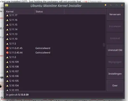

You can use Ubuntu mainline kernel installer to (un)install kernels. It is grafical (GUI), so you don't have to use the terminal. You can uninstall 107 and 105 and install a kernel older than 104. (It is wise to have at least 2 kernels installed, just to have one to fall back on when needed).
See screenshotenter image description here
Then use the 'mark hold' in apt & apt-get as suggested before by WU-TANG
To get mainline:
sudo add-apt-repository ppa:cappelikan/ppa
sudo apt update
sudo apt install mainline
