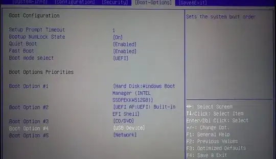

I've had a Windows 10 and Ubuntu 18.04 dual boot for a year. Both OSs work fine. My computer loads Windows by default on start-up, but I'd prefer on start-up to select either OS from the GRUB boot menu option or start Ubuntu at least. I went into the boot menu where Ubuntu is listed and then into the boot order setup, but in the boot order Ubuntu was not listed (see images).
Did I install Ubuntu wrong or is it because I have both Windows and Ubuntu on SSDPEKKW512GB (see images). I don't understand sysadmin and hardware stuff.
Is there a workaround that lets me have on start-up the boot screen or that loads straight into Ubuntu?
Sometimes I need multiple restarts followed by pressing Fn+F7 to get into the boot screen. Somehow they get ignored and Windows starts straightaway. Is this connected to the previous issues?

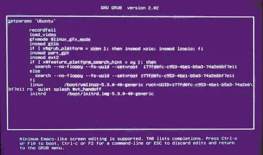

Just in case I attached my grub screen too.

I found the problem and a workaround. The comment by @karel is insightful, but I don't have the knowledge to try it out. Instead, I found another way to choose the OS on start-up.
The problem: In the UEFI [Boot-Options] tab, as you see in the screenshot in the question, the setup prompt timeout was by default 1 sec.
The fix: I set it to a slightly larger value, 3 sec! I guess the 1 sec was too short so that on start it wouldn't get me every time into the UEFI boot screen by pressing Fn+F7. Now, on every start without pressing Fn+F7, I get straight into the GRUB menu, where I have set Ubuntu as the default booting OS (here how to set the default OS)
