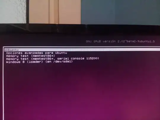

Recently I decided to install Ubuntu and Windows 8.1 in different partitions. They both work. The problem is that I want that the windows run with no key before 5 seconds, or put it the first.
