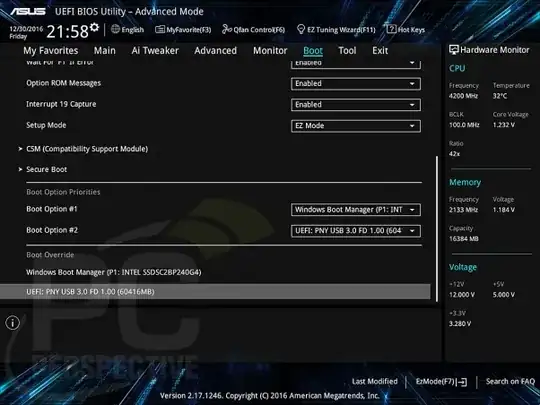

I have a laptop with Ubuntu installed as the only OS. I also have a USB stick with a Windows 7 installation on it. I want to install Windows from the USB stick on my laptop but when I try to restart the laptop to get access to BIOS, I can't seem to find the command for it, its like it skips everything and just says Ubuntu and then takes me to the login screen.
How do I change the boot priority to USB in Ubuntu?

The boot priority settings are often found under the Boot tab of the computer's BIOS/UEFI utility. The BIOS/UEFI utility can be accessed by pressing the key which is shown on the manufacturer's splash screen when booting. This is the F12 key on many computers. The keys to press, such as F12, F2, Del or Esc, differ on computers from different manufacturers. When grub bootloader is installed it does not change the key which is used to access the BIOS/UEFI utility.
When the power button is pressed to start the computer, it will try to boot first from whatever option is listed first in the boot priority section of the computer's BIOS/UEFI utility. If a USB flash drive is listed first in the boot priority list, it will try to boot from the USB flash drive first. If the internal hard drive where Ubuntu is installed is listed first in the boot priority list, the computer will boot to Ubuntu.

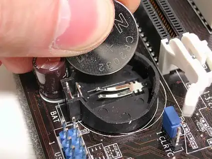

If you can't get into the BIOS setup utility at all because it's password protected and you forgot the password you can remove the BIOS password by removing the CMOS battery for 5 minutes and then putting it back in. This will also reset all BIOS/UEFI settings back to their defaults.
CMOS battery
CMOS battery
