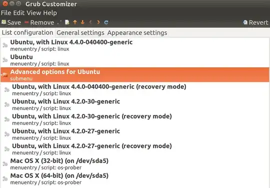

Here's a snapshot of the grub-customizer tool:

I noticed that /boot/grub/grub.cfg did not have the proper kernel list in it... after some more searching, the second answer here worked for me:
sudo exec grub-mkconfig -o /boot/grub/grub.cfg
