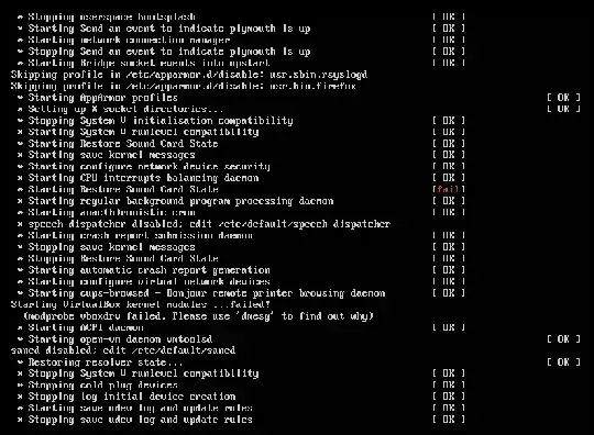

I ran apt-get dist-upgrade as follows:
Calculating upgrade... Done
The following NEW packages will be installed:
  linux-headers-3.19.0-51 linux-headers-3.19.0-51-generic
  linux-image-3.19.0-51-generic linux-image-extra-3.19.0-51-generic
The following packages will be upgraded:
  linux-generic-lts-vivid linux-headers-generic-lts-vivid
  linux-image-generic-lts-vivid
3 upgraded, 4 newly installed, 0 to remove and 0 not upgraded.
Need to get 65.1 MB of archives.
After this operation, 288 MB of additional disk space will be used.
Setting up linux-image-generic-lts-vivid (3.19.0.51.36) ...
Setting up linux-headers-3.19.0-51 (3.19.0-51.57~14.04.1) ...
Setting up linux-headers-3.19.0-51-generic (3.19.0-51.57~14.04.1) ...
Setting up linux-headers-generic-lts-vivid (3.19.0.51.36) ...
Setting up linux-generic-lts-vivid (3.19.0.51.36) ...
After this, Ubuntu 14.04.4 x64 LTS doesn't boot correctly and hangs on this screen:
This happens on all VMs I'm trying. I can reproduce it by creating / reverting snapshots.

12
At Ubuntu Forums there's at least one thread showing that my issue is caused by the latest Ubuntu Kernel Update (linux-image-extra-3.19.0-51-generic):
http://ubuntuforums.org/showthread.php?t=2314723
Update:
@alexmurray filed a bug (which has been already confirmed) at https://bugs.launchpad.net/ubuntu/+source/initramfs-tools/+bug/1550090
Please vote over there if you're affected (please don't create "me too" answers here).
Update:
Fixed by 3.19.0-51.58~14.04.1
10
