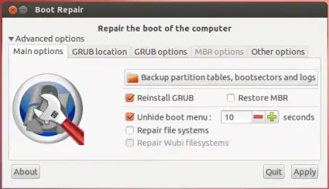

In case your grub2 is hidden and never shows then try Boot-repair.
Open a new Terminal, then type + enter:
sudo add-apt-repository ppa:yannubuntu/boot-repair && sudo apt-get update
and then enter
sudo apt-get install -y boot-repair && (boot-repair &)
Boot Repair
See advanced tab and check unhide boot menu.
