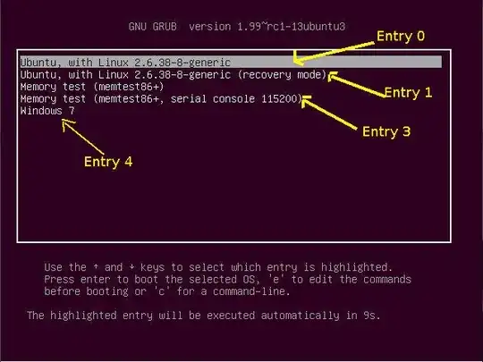

Here is how to change the boot order in Grub:
To change the default loading entry, you need to change the GRUB_DEFAULT as given below.
you need to edit /etc/default/grub . To do that,
Execute : sudo gedit /etc/default/grub
Now change the GRUB_DEFAULT=0 to any entry you wish.
The first entry is 0 , second Entry is 1 and so on..
