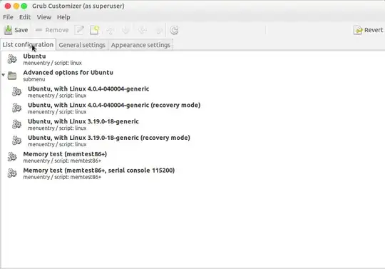

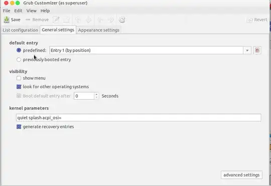

Use 'grub-customizer' as it's much more friendly then modifying text file.
sudo add-apt-repository ppa:danielrichter2007/grub-customizer
sudo apt-get update
sudo apt-get install grub-customizer
You will be able to figure out how to modify it properly via this tool, because it's really intuitive - that's for sure!
You update grub with upper left corner button: Save
RiddleMeThis
