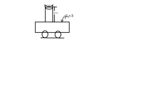

A uniform cylinder rests on a cart.The height and diameter is given.coefficient of static friction is given.How can i find the minimum acceleration of block such that the block topples?
Morever what is the reason of toppling? cylinder on block Again, if i consider static friction to be the cause,then what is the point of rotation?
If i consider the top to be te point of rotation,then why does the block topple with the lower end as point?I have conducted this experiment many times and if the block falls,it fell along the lower end.

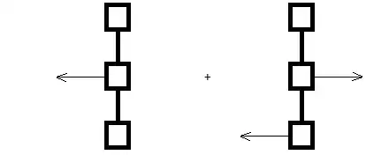

But to get the idea, we will look at the pieces of a simpler system. Three identical rigidly connected blocks are floating in space. You exert a force on the bottom block.
Forces and accelerations are vectors. You can add them together to see the total effect of multiple forces. This property of vectors is really useful. Sometimes replacing many little forces with one big force makes a calculation simpler.
Likewise, you can pretend that one force is really multiple forces, so long as the sum is the same, and you are careful to apply the forces at a points that produces the same torque. Sometimes this allows you to consider a problem piece by piece, where each piece is easier to understand.
You get the same accelerations (and therefore the same motion) with these three forces, because two forces on the middle block cancel.
Divide the problem into these two pieces.
A force through the center of mass accelerates the system without rotating it.
Two equal and opposite forces, not on the same line, are a torque. They rotate the system without displacing the center of mass. The torque will move the bottom block forward, the top block backward, and leave the center block still.
If you apply the three forces for a short time, they will cause small displacements to each block. Small displacements are vectors. The total displacement of each block is the sum of displacements from each piece of the problem.
The bottom block has two (unequal) forward displacements. The middle block has one displacement. The top has a forward displacement and a backward displacement.
If you drew a line through the blocks, you would find some point on the line doesn't move. For that point, the forward displacement from one part of the problem cancels the backward displacement from the other. It turns out this point is between the top and middle blocks.

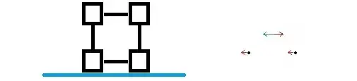

To see why a minimum acceleration is needed to topple the cylinder, we will look at 4 blocks sitting on a cart. When the cart is still, there are two external forces: gravity and an upward force from the surface of the cart.

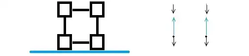

I have drawn the external forces off to the side. Gravity exerts a force $mg$ on each block. You should be able to see that this does not cause any rotation.
The cart exerts an upward force that is just strong enough to keep the blocks from penetrating the surface of the cart. This is $2mg$ on each bottom block. This does not cause any rotation.
We would get the same result if gravity was a single force, $2mg$, applied to each bottom block.

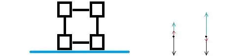

When the cart accelerates slowly, friction adds small torques and an irrotational force at the center of mass. This shows only the new forces.
Note that we would get the same result if torques like this had been applied.
The surface of the cart exerts an upward force just strong enough to keep the blocks from penetrating the surface. Notice the upward forces must be unequal to prevent rotation, which would cause the back block to penetrate the surface.
