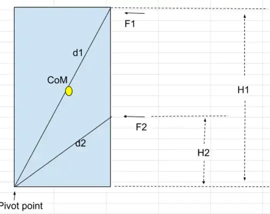

I have a question to confirm if my "hunch" is correct. Assuming 2 scenarios of similar force but is exerted at different height of a rectangular object with a pivot point (shown in the pic below). Based on Torque (perpendicular force * distance from the pivot point), it should be easier to tilt the object from F1 location vs F2 location assuming a similar amount of Torque needed to lift the object. Torque=d1 * F1 = d2 * F2 ). Based on that formula, then F1<F2 to get same torque.
However, when I use the 2nd class lever equation, I find F1 ==F2 based on the equation below: Assuming the CoM is in the middle of the object, using the 2nd class lever formula, i.e. d1 * F1= mg(CoM)* 0.5 *d1) , and so F1 = (mg(C0M) * 0.5 * d1)/ d1. I used the same formula for F2 and I found out F1=F2. Is this the exact force to tilt the object and if so, why both F1=F2 when it should be F1 < F2, or am I confusing force and torque?

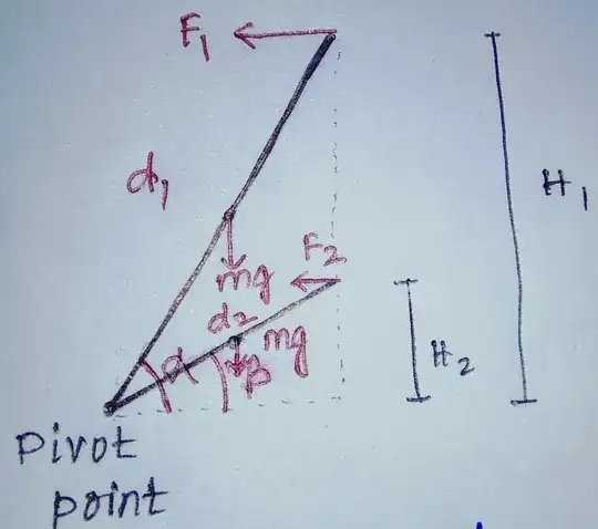

enter image description here First of all, torque is the product of force and the distance of a point from the pivoting point perpendicular to the direction force.So, $${\tau} = {\vec r}\;×\;{\vec F}$$ $${\tau} = |{\vec r}||{\vec F}|sin{\theta}$$ where ${\theta}$ is the angle between $\vec F$ and $\vec r$.
So, you must first resolve the forces.
Now, for the line of length ${d_1}$ ,
Angle between $\vec {F_1}$ and $\vec r$ is $\alpha$

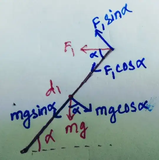

Component of $\vec {F_1}$ perpendicular to $\vec r $(along $d_1$)= $${F_1}sin{\alpha}$$ Angle between ${mg}$ and $\vec r$ is $$(90°-\alpha)$$ Component of $mg$ perpendicular to $\vec r$= $$mgcos{\alpha}$$ enter image description here So, net torque: $${\tau}= {F_1}{d_1}{sin\alpha}-{m}{g}{cos\alpha}(\frac{d_1}{2})$$

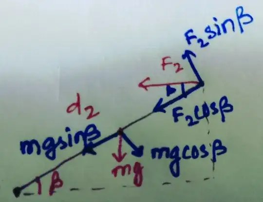

Similarly for the other line of force, $${\tau}= {F_2}{d_2}{sin\beta}-{m}{g}{cos\beta}(\frac{d_2}{2})$$ enter image description here

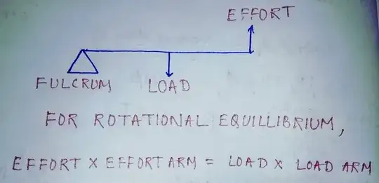

Now talking of $2^{nd}$ class lever, enter image description here The formula that you have used,i.e., $${Effort}×{Effort\;arm}={Load}×{Load\;arm}$$ Only applies for balanced situation (rotational equilibrium).In that case, $${F_1}{sin\alpha}({d_1})={mg}{cos\alpha}(\frac{d_1}{2})$$ $${F_2}{sin\beta}({d_2})={mg}{cos\beta}(\frac{d_2}{2})$$
But, as you are lifting of the block and rotating it around a pivot point (say anticlockwise), you cannot apply that equation for second class levers as the stick is not in rotational equilibrium. So, in this case(for anticlockwise rotation): $${F_1}{sin\alpha} > \frac{{mg}{cos\alpha}}{2}$$ (I have cancelled $d_1$ from both sides) $${F_2}{sin\beta} > \frac{{mg}{cos\beta}}{2}$$ (cancelled $d_2$ from both sides)
