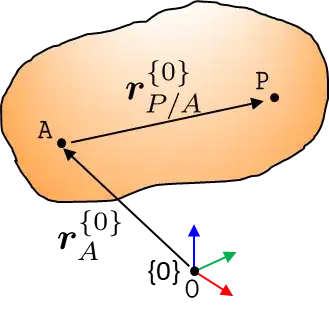

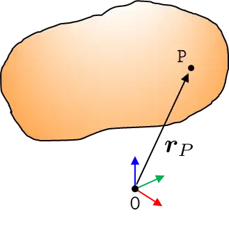

The location of a point P as measured from the origin, is $\boldsymbol{r}_P$ and the components are expressed on some common basis vectors (world coordinate system).
You are free at any point to decompose this vector into two vectors, based on another arbitrary point A. I have designated the world basis vectors as {0}.
fig2
The vector $\boldsymbol{r}_{P/A}^{\{0\}}$ means the coordinates of P relative to A in the {0} basis vectors.
$$ \boldsymbol{r}_{P/A}^{\{0\}} = \boldsymbol{r}_{P}^{\{0\}} - \boldsymbol{r}_{A}^{\{0\}}$$

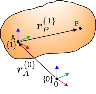

Now we can define this relative vector on a body coordinate basis vectors {1}
fig3
where $\boldsymbol{r}_{P}^{\{1\}}$ is the location of point P as measured from the {1} coordinate frame. This is a fixed vector. The components of this vector do not change with time.
In order to relate the vectors on two different basis vectors you need a rotation matrix $\bf{R}_{\{0\}}^{\{1\}} $ that contains the unit vectors of {1} as columns.
$$\bf{R}_{\{0\}}^{\{1\}} \boldsymbol{r}_{P}^{\{1\}} = \boldsymbol{r}_{P}^{\{0\}} - \boldsymbol{r}_{A}^{\{0\}}$$
and the re-arranging of the above to get the decomposition
$$\boldsymbol{r}_{P}^{\{0\}} = \boldsymbol{r}_{A}^{\{0\}} + \bf{R}_{\{0\}}^{\{1\}} \boldsymbol{r}_{P}^{\{1\}} \tag{1}$$
