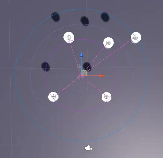

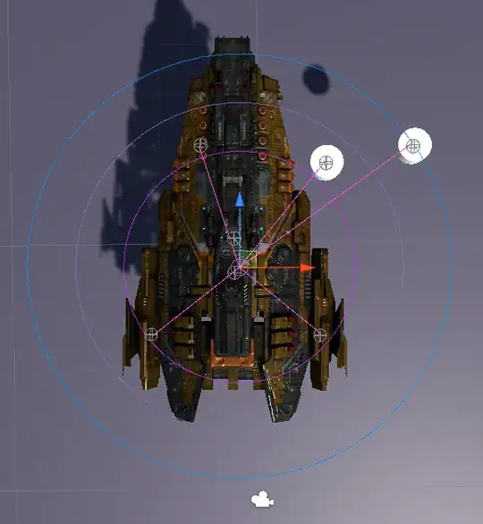

My game is going to be based on "hover craft". So I am currently trying to displace their mass * gravity so they hover above the ground at a set height. Below is a screenshot of a "space ship" in the game I'm making from the top down. The second picture is of the same ship, but without the ship model. The white pucks you see are actually "Boosters" which are supposed to be supplying a force equal to the weight of the ship at that point. (For demonstration purposes, assume all of the pucks are attached rigidly and there is no bend/play in any material - even if by an imaginary line). I've placed the pucks arbitrarily because I will eventually have non-symmetrical ships and I would like to account for changing masses on the ship, like a weapon falling off or an entire booster falling off.
For reference, my ship has a total mass of 1125, which comes out to a weight of 11036.25.

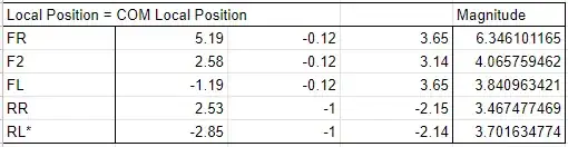

This second shot shows better the placement of the boosters. Again, each white puck is a booster. The magenta lines lead towards the calculated center of mass. The concentric circles are just the circumference based on the radius of the closest (light purple), farthest (blue) and average (purple) distances from the COM. Below are two screenshots, one with x, y, z coordinates and the second is with each of their distances from COM.
Finally, with code, I've made "scales" that will measure the weight and calculate their own percentage during run-time. I've placed the scales directly below each booster so that I can see the percentage of weight each booster will need to carry. I can't use this during run-time for various reasons, but to find the final answer and (I hoped) to work backwards, I at least have the final percentages.
