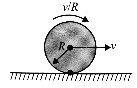

Let us observe the bottom point of an extended circular body in pure rolling. enter image description here
Pure rolling is a type of combined translational and rotational motion. This means that all the particles of the body are both moving linearly and in a circle. Hence, every point on this body has two velocities, one equal to the velocity of the center of mass ($v_m$), and the other angular ($\omega$).
Let's now observe the bottom most point. We say it is 'at rest' because the vector sum of velocities is zero. $$v_m+(-\omega R)=v_m-v_m=0$$ since $v_m=\omega R$.
However, we know that all points of a body in rotational motion have an angular velocity. When an object is rotating, all its particles will feel an internal centripetal acceleration towards the axis of rotation.
This must be true for the contact point as well. It has, at all times, an internal centripetal acceleration equal to $\omega^2 R$. This acceleration acts on this point at all times, whether it is at the top, side, or bottom.
It is this acceleration that internally 'pulls' the bottom most point back upwards and allows the body to remain in rotational motion.
Note: It's important to note that the reason the body doesn't 'break' is because all these internal forces cancel each other out. The way to not run into the confusion you're having is to think of centripetal force as a prerequisite to circular motion rather than an effect. If at any point the value of $\frac {v^2}R$ is less than the minimum required centripetal acceleration, the body will leave circular motion. In rolling, each particle always satisfies circular motion. So, all points in the body will have centripetal acceleration.
