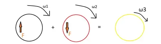

Picture Explaination
The law of conservation of angular momentum states that when no external torque acts on an object, no change of angular momentum will occur.
Yes there is friction between the discs,when they come into contact .
Consider the resultant of the friction forces acting on the discs to be F. As shown above they are an action-reaction pair.They are internal forces. One wouldn't be there if not for the other. So if you consider the torques due to these forces, they cancel-out as they will be opposite and equal to each other.
Hence we can safely apply the Law of conservation Of Angular Momentum.
