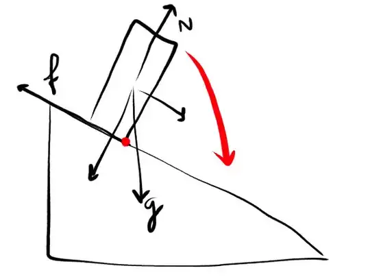

I'm wondering what makes a tall box rotate about its edge (the red point on the figure below) on a inclined plane (with or without slipping), when subjected to forces of gravity and friction only:
Both the box and the plane are idealized (no imperfections).
According to the answers to this question about a ball rolling an inclined plane, gravity force plays no role in rotating the ball, so I think that is the same case for the box: the gravity force is resolved into two perpendicular components: one opposite to the normal, and the other parallel to the plane, sliding the box down the plane (without rotating it).
In the case of the rolling ball, the friction force is what actually rolls the ball, by applying a torque about the center of the ball at a distance R (ball radius).
But in the case of the tall box, I see that the axis of rotation is not the center of gravity of the box, but the point of contact in the base of the box (the red point in the image above). The box rotates about this point. The problem is that the friction force has no tangential component with relation to the point of contact: its line of action passes through the point of contact. It would not be able to produce a torque about this point.

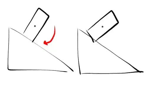

I can't see this box rotating about its center of gravity either (as in the case of the ball), because the box has edges which would "penetrate" the plane, as the image below:

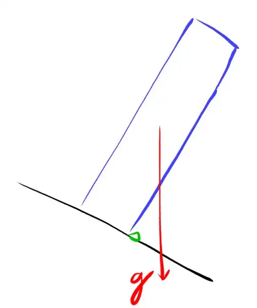

The only situation where I can see the box rotating about the edge is if the inclined plane contains imperfections, so the box edge would be resting on this imperfection (the imperfection is depicted in green on the image below). But in this case rotation about the edge would be caused by the component of gravity parallel to the surface and not by the friction force, right?
So, is it correct to conclude that the perfect tall box, starting from rest and with its center of gravity pointing outside of this base, would not rotate at all on a perfect inclined plane (it would just slide)? Is there a scenario where it would rotate? And what would be the conditions for slip/no slip?

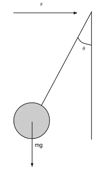

The problem is that in the frame of the plane, the axis you want to consider in the question (the front corner of the box) is accelerating. I don't think that's okay to do. Let's imagine a pendulum being accelerated via a force on the axis. And we let it reach steady state so the angle isn't changing.
pendulum
The solid pendulum has a force accelerating it to the right, and it has gravity pulling it down. The force is applied directly at the axis and contributes no torque. Gravity pulls the weight down, so is applying a torque of $(mg \times L\sin \theta)$. Yet the pendulum does not rotate. Perhaps someone else has more information about this situation. My intuition is that this is simply the wrong technique for an accelerating axis, but I'm not sure what the correct analysis would be.

Take a look on the forces diagram in the first picture. Let's ignore the force $N$ for now, it can only contribute to the tipping (due to its orientation), but since it is going to be confined to acting only on the red point as soon as the tipping occurs (if it does), it won't have any influence at all. E.g. it produces zero torque about the red point. Friction is disregarded as stated in the question.
The only remaining force is gravity. Let's say the box has mass $m$, height $h$ and width $w$ and the plane is inclined by angle $\alpha$ (the rightmost angle in the top drawing). Gravity can now be separated into the parallel to the plane part $m g\sin(\alpha)$ and perpendicular to the plane part $m g\cos(\alpha)$.
Their torques about the red point are obtained by multiplying them by the perpendicular distance from the red point to the center of mass (that is where the forces act, since it is gravity we are talking about). The torques are $m g h \sin(\alpha)/2$ in the clockwise direction (due to the part that is parallel to the plane) and $m g w\cos(\alpha)/2$ in the counter-clockwise direction (due to the perpendicular part).
The box will tip if clockwise torque exceeds the counter-clockwise, that is when $\tan(\alpha)>w/h$. This also happens to be the condition that center of mass points outside of the box.
